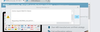

I installed Creo 6.0.2.0.  I keep getting this error message and shuts off when I click OK.  There was never an older version of Creo installed in this computer.

did you follow procedure described in https://apps.ptc.com/schools/references/install_creo6_schools_standard.pdf -OR- https://apps.ptc.com/schools/references/install_creo6_unistudent_standard.pdf ?
What Product code did you enter during installation ?

I am also following this as have same problem, followed the pages to the letter but the licence I was sent says creo parametric 5.0 how do I get version 6.0?

I am sorry I do not have any "magical" advice.
During Creo installation you have to follow 2 basic rules:
  • hidden directory C:\ProgramData\PTC\Licensing must be empty
  • one of following Product codes must be used
               K-12 students can use Product code BE600908EDSTUDENTEDK12
               University students can use Product code BK600908EDSTUDENTEDUNI
