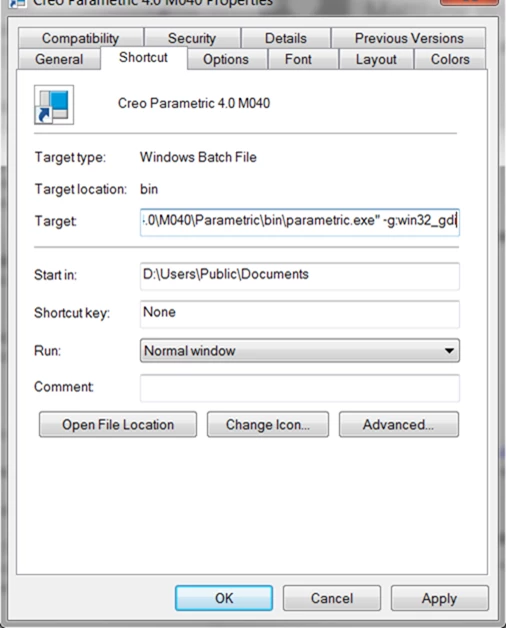

Oct 24, 2019 5:40 AM UTC
Right-click on the PTC Creo Parametric shortcut on the desktop and go to properties. Add space after the existing target path and then -g:win32_gdi. Click on apply and run the Creo. This will exclude any graphic card related issue.
Also check if the graphic card driver is updated.
Alex
Oct 25, 2019 6:46 PM UTC
Managed to run fine (for the most part) on the integrated graphics card, however after making the recommended path change listed above the graphics (lines and shading in a sketch, and shading on a part) have become buggy, resulting in improper color/shading rendering.
I have also had issues with the hidden line feature not working correctly in drawings, as well as being unable to erase said lines using the edge display feature. Attempts to erase simply change the color of the selected line.
