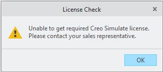

CREO 6.0 simulate not working with my student license
This message appears every time I try to open a parametric file in CREO 6.0 simulate. My classmates have been able to use simulate with their licenses, am I doing something wrong?

Creo Student license file does not contain CREO Simulate license. Please read https://community.ptc.com/t5/PTC-Education-Forum/Creo-5-0-Simulate-for-Student-Version/td-p/587984 discussion.

In case you need access to Creo Simulate, you can use the university campus license or purchase Creo Student Premium from the eStore (store.ptc.com).
