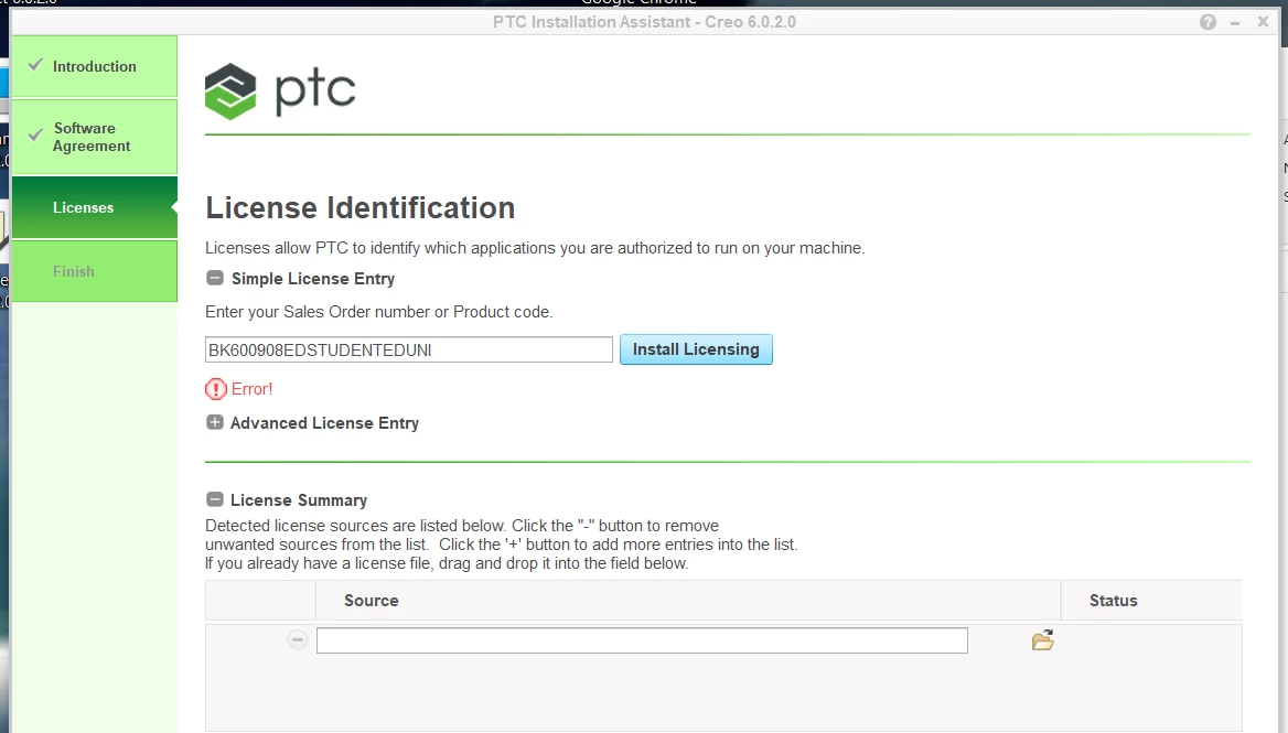

I'm installing the PTC student edition.  The installation of the licence fails every time no matter what I try.
I've cleared the license directory and tried again.
Over wifi (normal operation) I get the attached error.
If I disable the wifi and  install it over fixed cable connections it gives me a succes but when I run it it,says that there are no licenses.

both files are OK.
ip.txt tells me that Ethernet adapter with MAC address 50-9A-4C-BF-63-BD is running.
BK600908EDSTUDENTEDUNI_license - kopie.dat.txt contains license code generated for MAC address 50-9A-4C-BF-63-BD.
License file enables you to run Creo Parametric 6.0 ... license name = CREOPMA_Student6
Suggestion:
  • save BK600908EDSTUDENTEDUNI_license - kopie.dat.txt as C:\PTC\my_Creo6_license.dat
  • edit parametric.psf file located in Creo_loadpoint\Creo 6.0\Parametric\bin directory
    • this file must contain following lines
      ENV=PTC_D_LICENSE_FILE-=C:\PTC\my_Creo6_license.dat
      ENV=CREOPMA_FEATURE_NAME=CREOPMA_Student6 ()

Have you followed this guide - "PTC Creo 6.0 - Student Edition - Quick Installation Guide"?
December 2, 2021
Yes I did.  Did it multiple times, always same result over the Wifi the error and over the ethernet connection a success but it doesn't work.

my suggestion:
  • move all files from C:\ProgramData\PTC\Licensing directory to another one
  • disable the wifi and  install it over fixed cable connections
  • upload license file located in C:\ProgramData\PTC\Licensing directory ... I will check its contents for you
Open Command prompt window, launch ipconfig /all  > ip.txt command and upload ip.txt file  ... I will check its contents for you.
