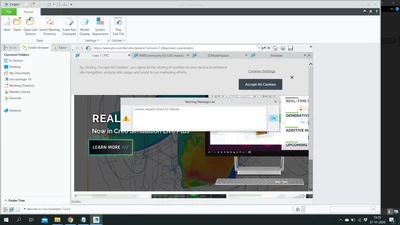

I am trying to install creo 7.0 for students. After installing i tried to open creo parametric but recieved this error:
There is not a lot of information about what is wrong with the license.

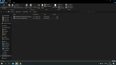

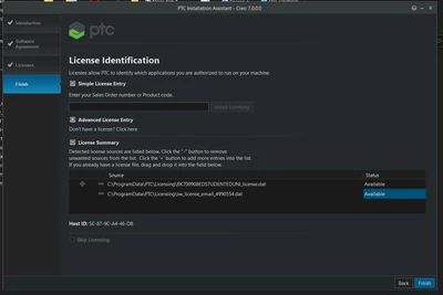

Here I could open a .pdf and found this license code: BK700908EDSTUDENTEDUNI
Then i used this in the installer and it created a license (name : BK700908EDSTUDENTEDUNI_license.dat)
This file is uploaded with the post.
Since this didn't work I also tried to use a license that was send to me by email.
(name sw_license_email_4990554.dat)
Both don't work. Then i have also tried to recieve a license via k12 students with similar results.
In the installer the codes are available but they don't work for creo parametric.

It's been almost 3 months so I hope you're not struggling with this but I just had the exact same error and was finally able to get it fixed. Here's what I did:
1. Go to ...ProgramFiles\PTC\Creo 7.0.2.0\Parametric\bin
2. Copy the file "parametric.psf" (PTC Startup File)
3. Paste this file to your Desktop
4. Open this file with Notepad
5. CTRL+F and search for the line "ENV=PTC_D_LICENSE_FILE", this is the license file CREO is looking for. For me it was the wrong one and it appears it is for you too.
6. Replace the file name with the correct file (for me modifying BK600... to BK700...)
7. Drag this file back into the ...ProgramFiles\PTC\Creo 7.0.2.0\Parametric\bin folder.
8. Click "Continue" to perform this action as an administrator
9. Run CREO, it should work now.
NOTE: You're going to have to edit the file in your desktop or somewhere other than the bin folder and drag it back in after your edit. It will not give you permission to edit it in the bin folder.

make sure you are using the correct code for the version of creo you are trying to install. If you are following a creo v6 instruction pdf while trying to set up creo v7, you will get the same error.
