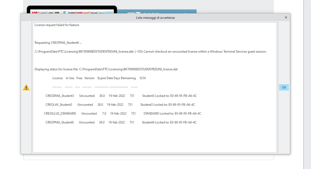

when I open Creo parametric the program exits this screen.  I have already tried to find a solution for th esame issue.

you cannot run Creo in Windows Terminal Services client window.
February 26, 2021
it may be because I use a remote connection for use creo?
thank you
February 26, 2021
thank you
yes, you are right. Student license is not available when you connect using remote connection. If you connect using Teamviewer it will work (I hope).
