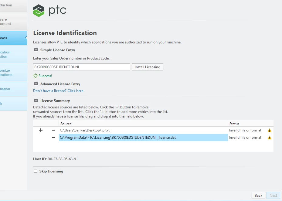

Creo 7.0 Student edition Licensing Failure
After I input the licence key it shows "success" and also says "invalid file or format". I have attached ip.txt.
please upload license file(s) located in C:\ProgramData\PTC\Licensing directory.
September 14, 2020
Here it is. (The file had extension .dat I have changed it to .txt)
September 14, 2020
The file seems to be empty. Please delete it, run setup.exe in admin mode, select reconfigure existing software and use this product code:
BE700908EDSTUDENTEDK12
Alex

Possible solutions for "Invalid file or format" status under License Summary while installing Creo: https://www.ptc.com/en/support/creo-admin-troubleshooter/other-symptoms/invalid-file-format
