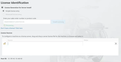

i'am having trouble installing CREO 8 parametric for students wih my student account. it get stuck on the processing part of the license. i'll be glad if someone can help me.
November 25, 2021
Please show a screenshot of your issue.
November 25, 2021
I'm having the same issue. The setup won't move past processing the license.
November 25, 2021
Here's a possible solution: "Something is blocking the connection between PC and the licensing server. Please make sure that you temporary disable the antivirus and firewall during the licensing process".
