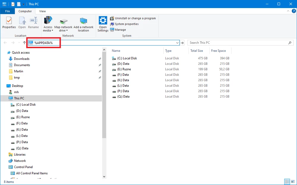

Not sure where to find %appdata%?
May 22, 2024
type %APPDATA% into address field of File Explorer and press ENTER. Then search for PTC subdirectory.
