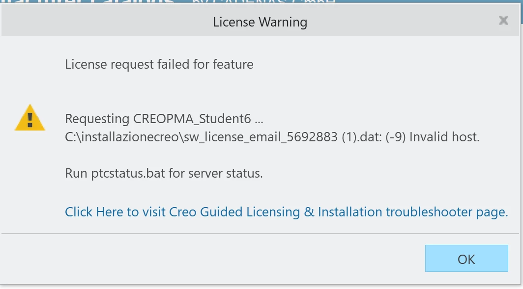

Good morning,
I am a student and I have been working with creo 6 since two years, a month ago I downloaded the creo 8 version and I was able to work with it until yesterday, when an issue with the licence came up.
I attempted many new installations disinstalling every other version but I think I now have reached the maximum number of licences for my account.
Is there any way I can solve this problem?

error message tells you that MAC address used in license file does not belong to any network card installed in your computer.

please do following:
1.]
Pack your license file into zip file and upload this zip file.
2.]
Open Command prompt window.
Run ipconfig /all > ip.txt command.
Pack ip.txt file into zip file and upload this zip file.
I will check the contents of both files and let you know what to do (in case I know).
