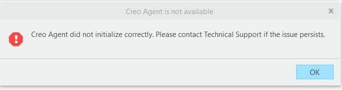

Issue:
Error - "Creo Agent did not initialize correctly. Please contact technical support if the issue persists".
Reasons/Causes:-
  • Error message indicates that creoagent.exe either has not been launched or has exited prematurely
  • Encryption software or antivirus software cause this issue
  • Fail to install creoagent.exe
  • Unable to install Creo Platform service due to lack of admin privileges

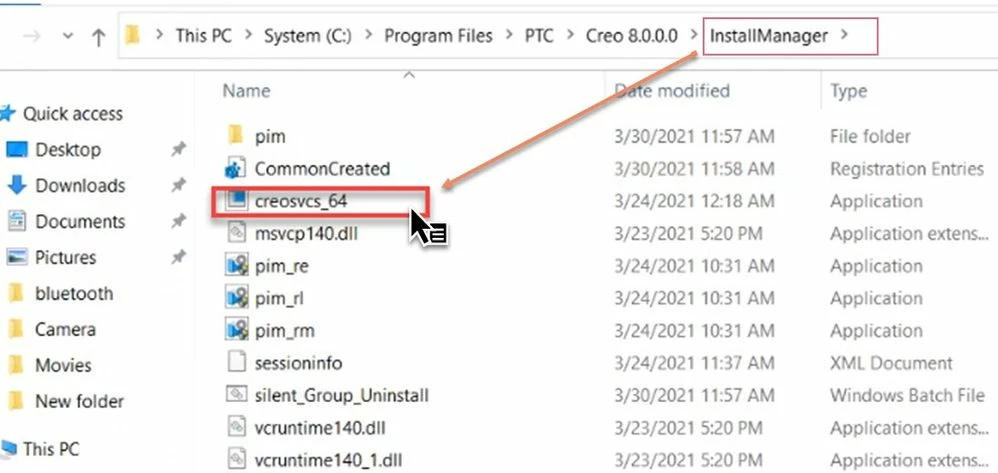

Solution: -

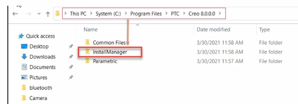

  • Browse to Creo Parametric Trial installation folder C:\Program Files\PTC\Creo 8.0.0.0\InstallManager
  • Run creosvcs_64.exe as an administrator
This should help resolve the error encountered.
