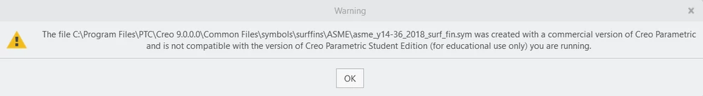

I have been having problems with my Creo 9 (Student Edition) installation.
When I try to open the Surface Finish Gallery or the Hatching Configurator I keep getting the warning that the corresponding file "was created with a commercial version of Creo Parametric and is not compatible with the Creo Parametric Student Edition (for educational use only) you are running." after which the program shuts down completely.
I am sure this problem extends beyond the mentioned configuration files.
A re-installation of Creo did not fix this (neither did a second one).
There has not been any other version of Creo installed on my computer, nor have I uses any other license apart from the Student license I am currently using.
Is there a way to fix this problem?

Sadly these files that used to be in a neutral format got changed and your student edition can't open commercial files.
Simple solution is to simply run setup.exe again and choose reconfigure existing software. Use this product code:
BE900908EDSTUDENTEDK12
and finish the reconfiguration process. This should fix this issue.

the problem seems to be resolved as far as I can see.
Thanks, Konrad
