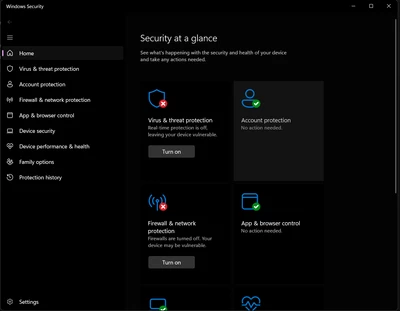

I turned off the antiviruses, and ran it as an administration, but it just doesn't open

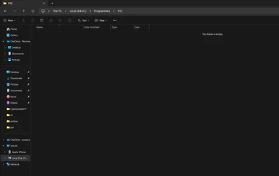

disabled all protection and deleted previous licenses, ran the setup.exe as an administrator and it just doesn't open

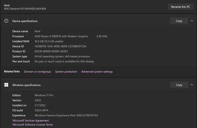

please provide following information:
  • detailed hardware configuration
  • Windows version
3-Newcomer
March 4, 2025
the laptops graphic card is nvidia 3070
