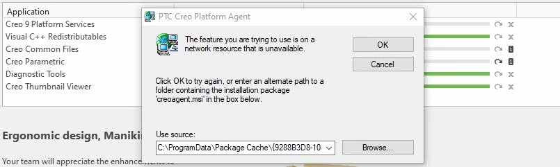

Creo installation issue
I'm encountering an issue with the installation of Creo. In the attached file, you can see that it's requesting the "Creoagent.msi" file, which is not present in the required folder. As a result, the installation process is halted at this step. Has anyone else experienced a similar issue before?
Thank you.
July 12, 2023
Hello again
I got a call from PTC support team and they managed to fix the problem. it seemed there was a duplicate registry file which was causing the issue with the installation.
Thanks for your attention in this matter.

please provide detailed description of all your steps starting with download action.
