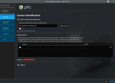

Hello!
I have Creo 10.0 with student license. In the past couple days when I started it up, I got an error message about my license: (-9), invalid host. I would reconfigure the license with setup.exe and it would work for a while. A day at max. I went on like this until yesterday when I couldn't reconfigure. After entering my username amd password for the license I got the very informative error message: Error!
Then at home I was able to reconfigure. Then today in the morning the same thing happened. I thought maybe reinstalling could help but I can't reinstall because I get the same error while trying. Any help is appreciated:)

Hello! Thank you far answering. I have been through these solutions when I got the incorrect host error message and they did not help. Now my problem looks like this:

I assume you have exhausted the number of license requests allowed.
Try sending request for license via email.
Please read https://community.ptc.com/t5/PTC-Education-Forum/License-Identification-Error/td-p/911756 discussion.
