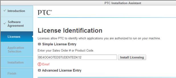

When installing Creo, there are two main licensing errors you might encounter:
  1. “Error!” text when inputting Product Code:
If you hover your cursor over the “Error!”, you should see a description of what went wrong.
Here are a few fixes to common mistakes:
  • When copying/pasting, make sure there is no space before or after the product code
  • While typing the product code, don’t mixed up the number zero (0) with the letter (O)
  • Make sure your login and password are correct
