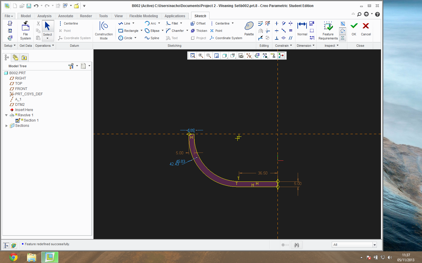

I have been using Creo Parametric 2.0 Student Edition for a while and it has worked fine until now. Yesterday, after checking a piece I rendered a couple of weeks ago something really weird happened. Whilst the sketch looks perfectly fine once the piece is rendered the view is completely messed up.
The sketch is the following. The sketch is revolved along an axis in the middle of the right and front plane:

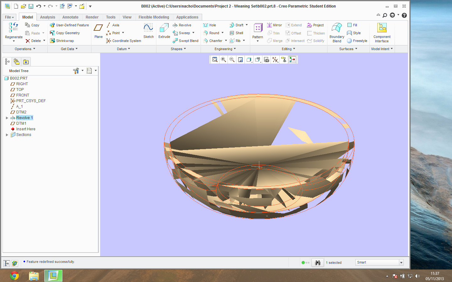

This shape worked fine every time since I first modelled it. However since yesterday it fails to generate a proper shape and it appears like this instead of how it should appear.
The rest of the shapes I've modelled work perfectly fine and this error only happens with this particular piece. When I edit definition everything appears normal but then the error happens once again. I have tried regenerating but it just doesn't work. Do I have to remodel the piece or is this error fixable?

    Sounds like something an update of your graphics card will fix:http://apps.ptc.com/schools/references/support_creo2_graphics.pdf.
    If not, please submit an Academic Support Request

    Have you tried to export part to step/iges and open it to see if geometry is ok? If its ok maybe gcard making problems.Try to raise shade quality+show small surfaces in options.
