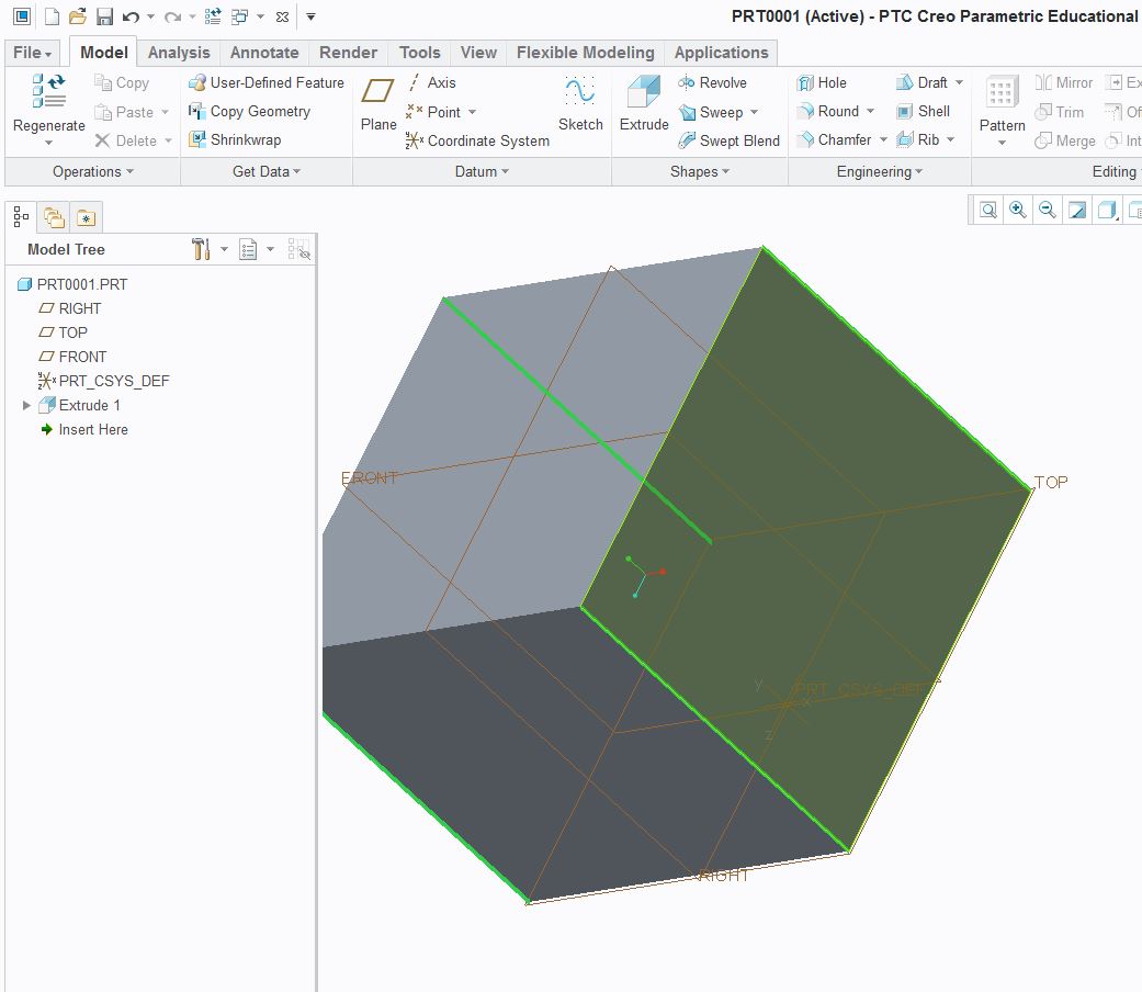

Look CREO 3.0 on Windows 10
Some kinds of problems like edges selection and the icons looks like fuzzy

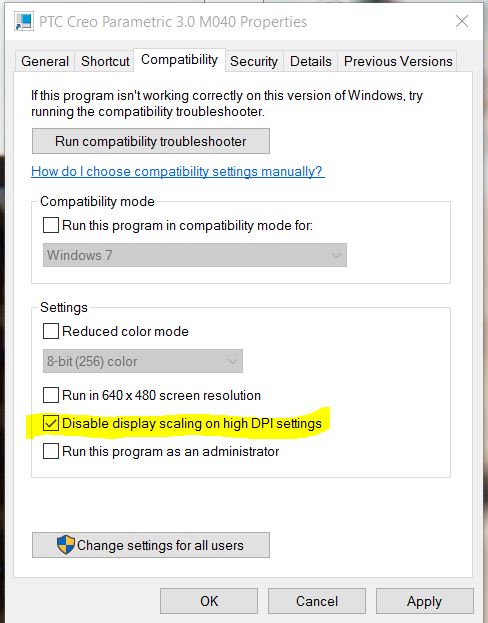

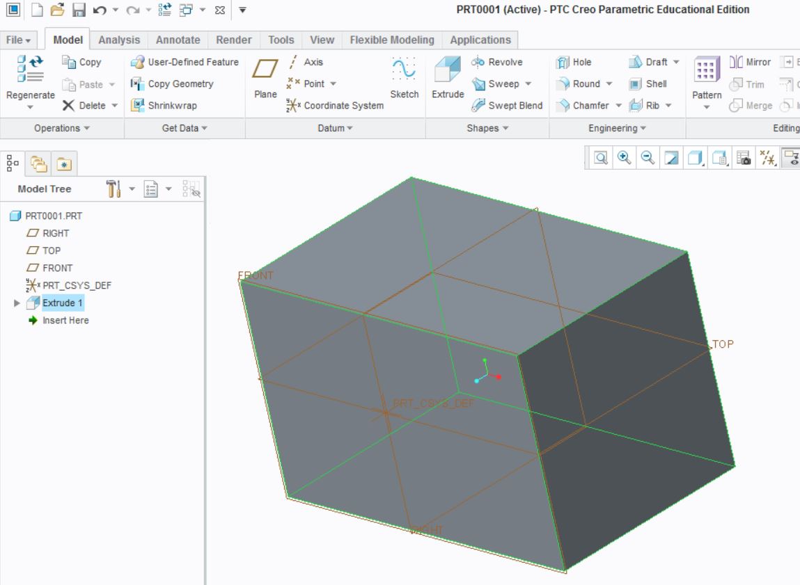

Look CREO 3.0 on Windows 10 with this change in settings Windows Compatibility
I can see the icons in HD, and the selections works so good, like in Windows 7

    How to go to that compatability check window
    April 3, 2019
    is there any other way in creo tool to relsove this issue
    April 3, 2019
    try setting 100% display resolution to resolve selection problems.
