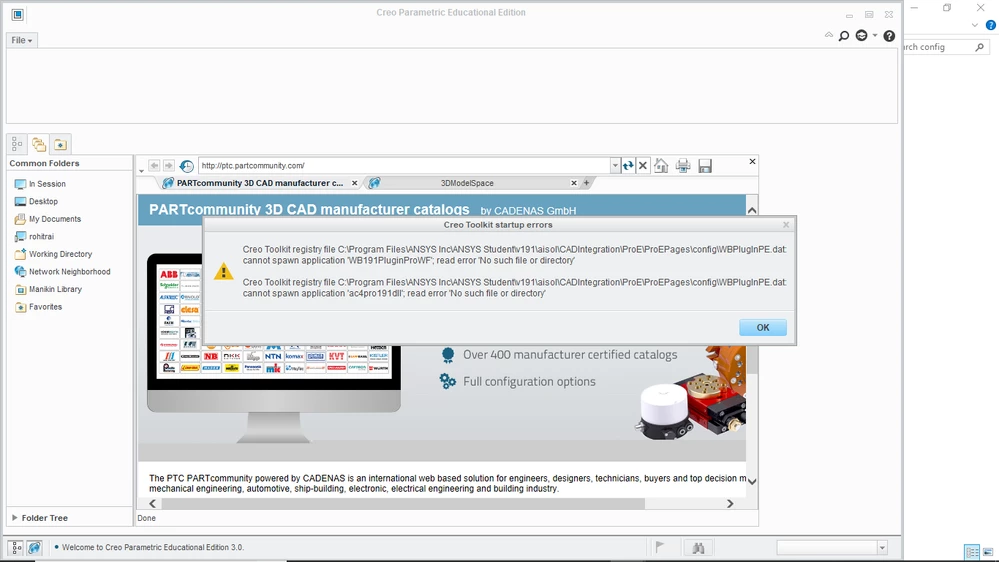

This is what appears when I try to setup ANSYS plugin in Creo Parametric 3.0.
Where is the problem? Is it with Creo, or with ANSYS? or my PC?
Please help me solve this
Thank You
November 20, 2018
  • open WBPlugInPE.dat in Notepad
  • check path to files mentioned in the file ... all these files must exist
