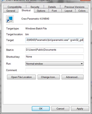

I downloaded Creo Parametric 6.0 and it won't run. I'm unaware if this is because of a specific file I needed to download before hand or not. Any assistance if greatly appreciated.

I followed the the pdf of instructions provided. First downloading the 4 GB zip file of 708 attachme. Then proceeded to unzip the files, opened as administrator and ran the .exe file. The pop up window appeared and I put in the licensing code, and l finished the download on the same window in a different tab with the progress bars. Now Creo Parametric, Simulator, etc. are now thumbnails and appear to be accessible; however, I am unable to run them. My curser spins for a half of a second on the first click and it never opens or shows any sign of operation.
 I hope that was more insightful. I am not getting any errors messages, which is why I’m not sure myself. Thank you again for the help

Right-click on the Creo Parametric shortcut on the desktop and go to properties. Add space after the existing target path and then -g:win32_gdi. Click on apply and run the Creo.
