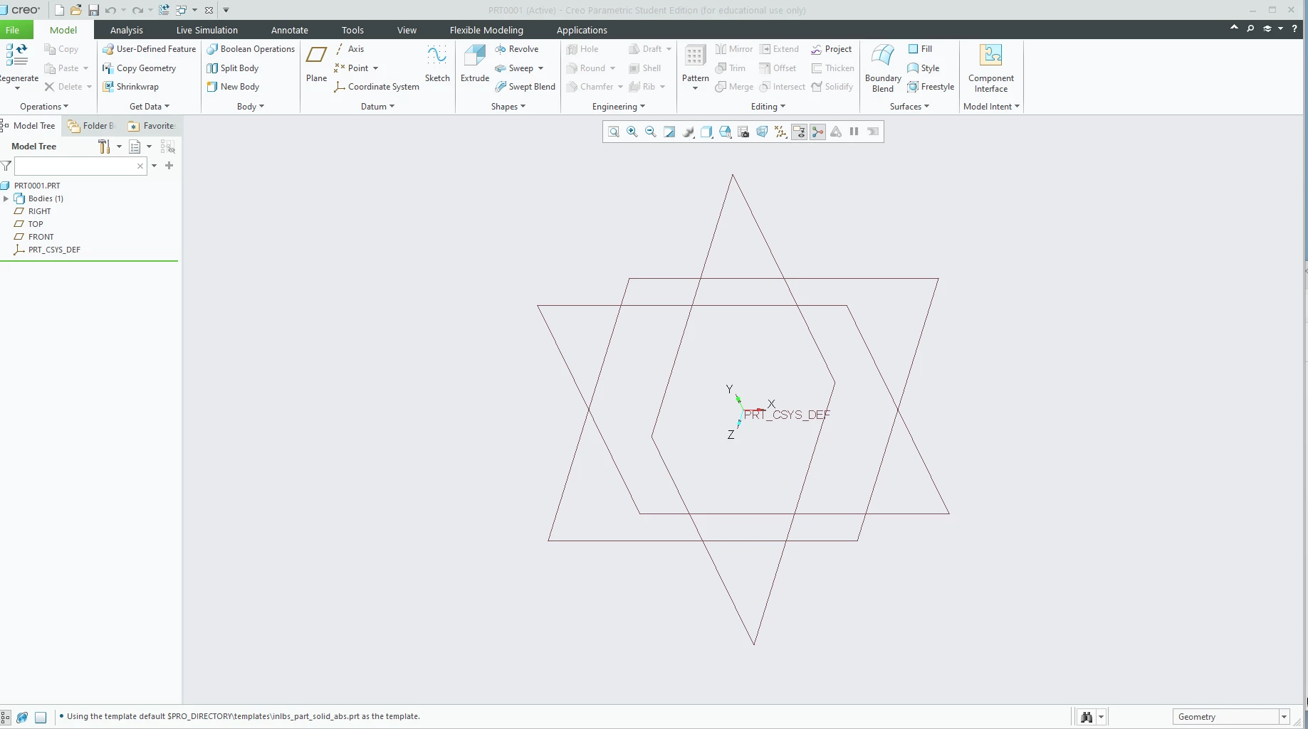

CREO PTC 7.0 student edition Planes not showing + weird background
  • December 27, 2023
  • 2 replies
  • 1649 views
I have recently installed creo ptc 7.0 student edition on my pc and now i have the problem, that my planes dissapear whenever i rotate the part/coordinate system. And also the Backgroung is completely white wgile it should be grey-ish to my knowledge. How do i fix this?

PS: also the programm doesn't snap to the active plane when making a sctetch/extrude/revolve like its supposed to and i have to center an allign it manually.

usually these problems are caused by wrong version of graphic card drivers installed.
Please publish:
  • graphic card specification
  • driver version
  • operating system version
