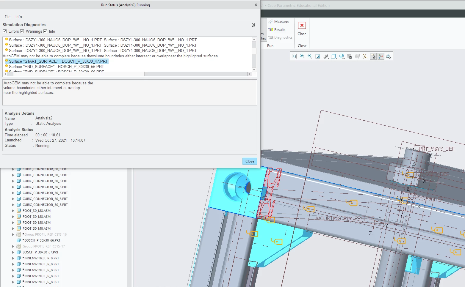

I had created profiles using the Bosch Profiles in creo 7.0 and then i am simulating it in creo simulate 7.0 but i found some errors. could anyone please help me.

Here's the article - "Mesh creation in Creo Simulate fails with message: "AutoGEM may not be able to complete because the volume boundaries either intersect or overlap near the highlighted surfaces" ": https://www.ptc.com/en/support/article/CS115533
November 4, 2021
This solved me from error by using contat Interferances
