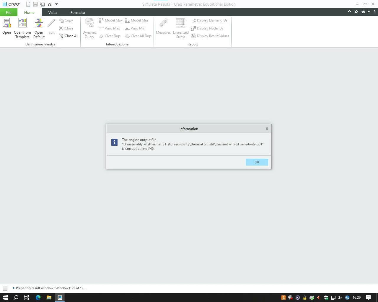

I had a very strange issue when trying to analyse some simulation results for a sensitivity study in Creo Parametric 9.0.
Still haven't understood where the problem could be, the only thing I was able to validate is that when using only default measures for evaluation there are no problems while if you define a personalized measure it shows the error message I posted in the attachment.
Anyone had similar issues and was able to solve?

Article - "Error "The engine output file "analysis/analysis/analysis.d01" is corrupt at line #0." when try visualize Displacement results in Creo Simulate": https://www.ptc.com/en/support/article/CS318094
March 26, 2025
Unfortunately I cannot access the article since I am using a student version of Creo but simulating with pc from my university, which has floating licenses 😞
