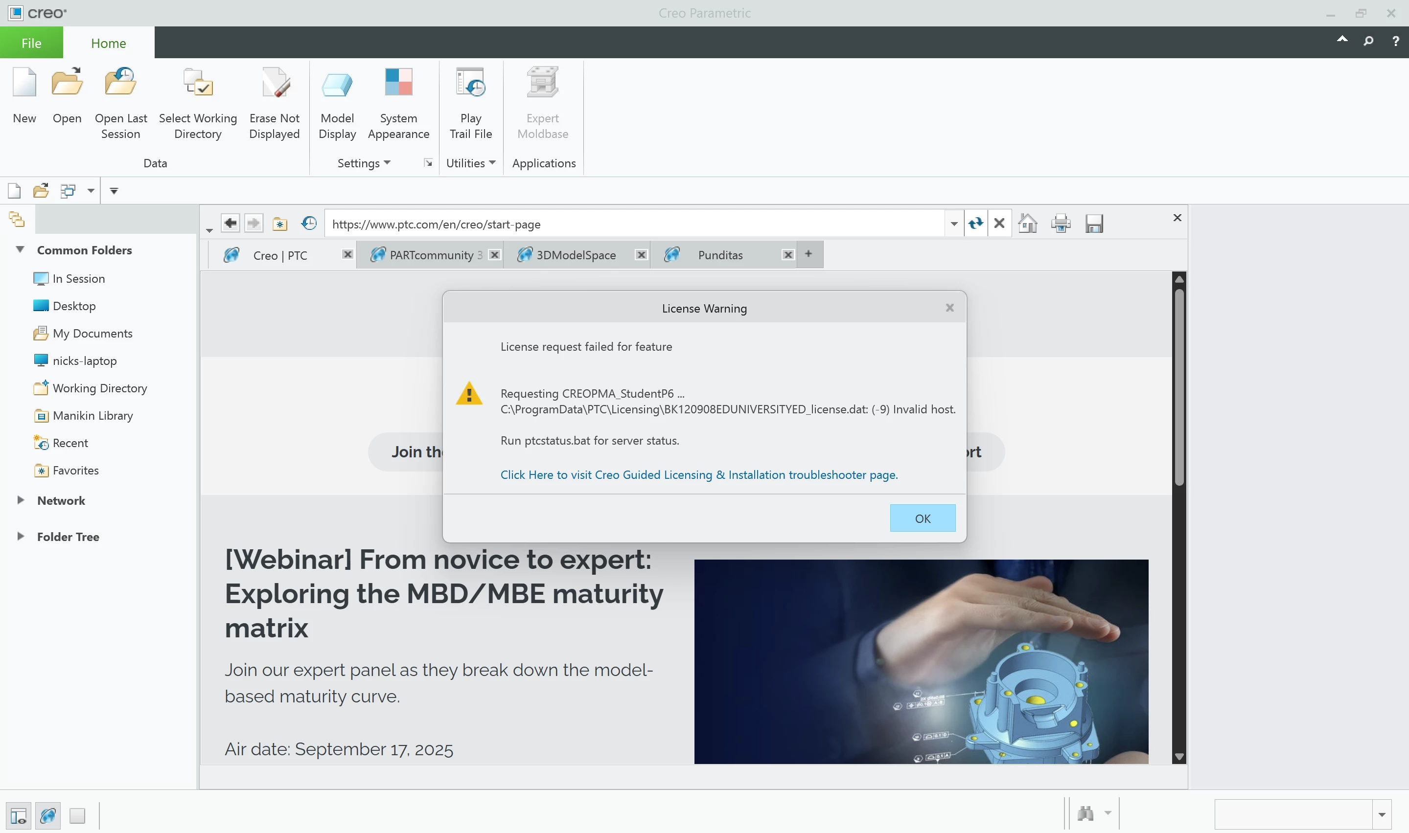

I’m a student trying to run Creo Parametric and my node-locked student license is failing with:

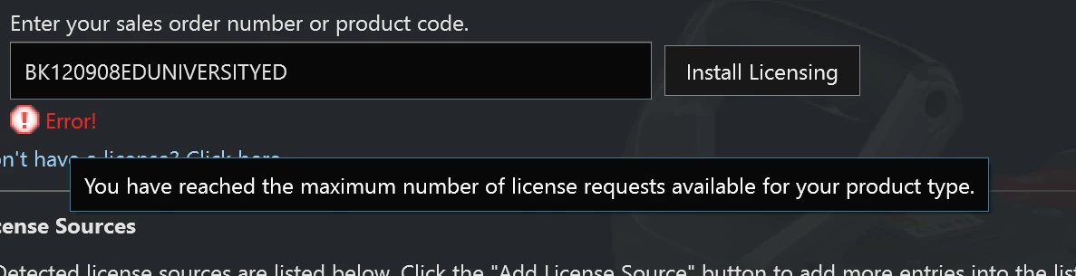

• When I run reconfigure.exe and enter my product code, I get: “You have reached the maximum number of license requests available for your product type.”

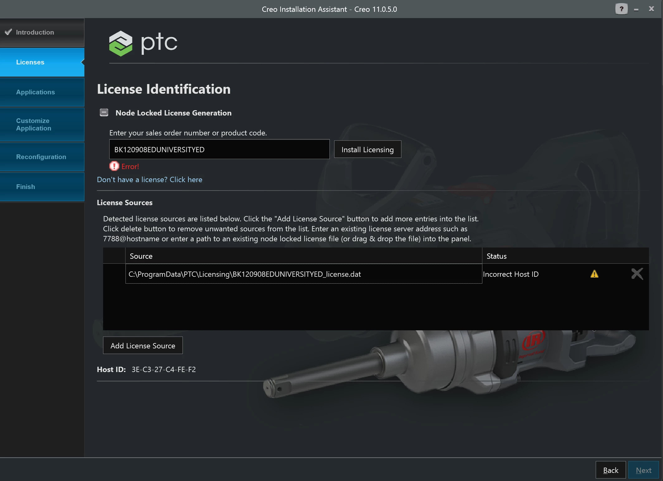

• Current active adapter MAC (host ID): 3E-C3-27-C4-FE-F2
• License file HOSTID currently tied to: 32-DA-63-A1-9A-2F
• Error dialogs: “(-9) Invalid host” in Creo; “maximum number of license requests” in reconfigure.exe
• License files path: C:\ProgramData\PTC\Licensing\

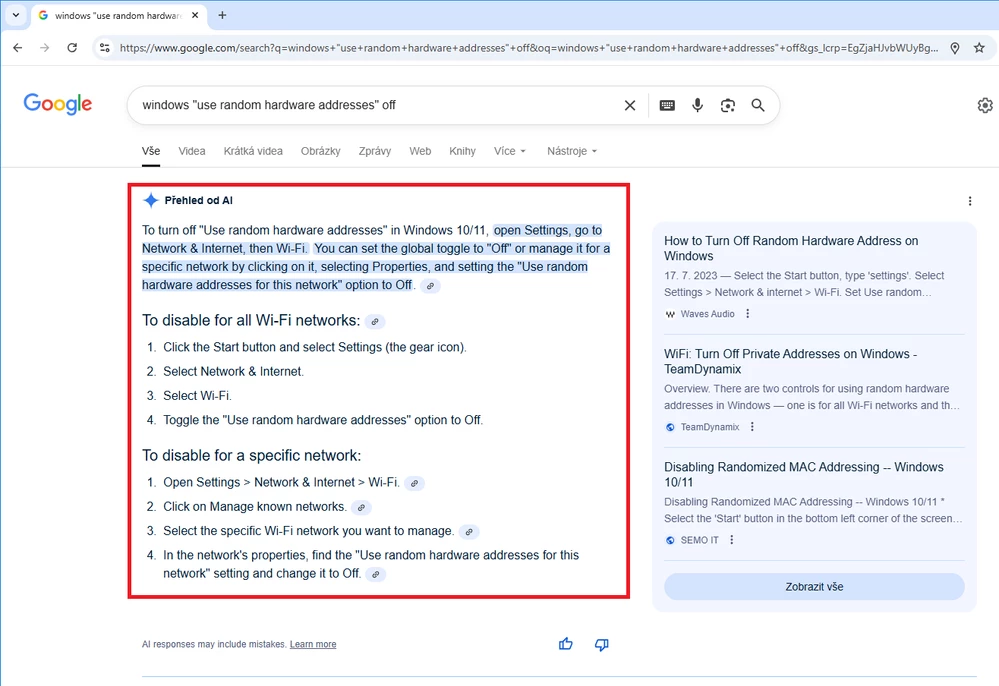

first of all you have to know the right MAC address. I can help you to solve this "problem" if you upload ip.txt file generated by following command executed in Command prompt window.
ipconfig /all > ip.txt
If your computer has an Ethernet card, then it's a good idea to use its MAC address.
If your computer only contains a WiFi card, then you must first disable randomization of its MAC address. Only after performing this action and restarting the computer can you find out the hardware MAC address of the WiFi card and use it to obtain a license.
