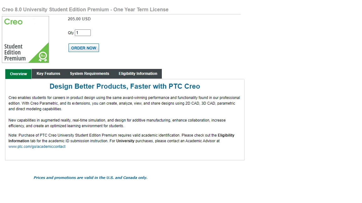

I'm interesting in buying the Creo Student Edition Premium because it's suppose to include Creo Simulate and I want to perform non-linear (large deformation) static structural simulations.  However, it's unclear what Simulate capabilities are included.  Can anyone tell me this*?  According to the Creo Simulate brochure there are multiple Simulate offerings: 1) Creo Simulation Live, 2) Creo Ansys Simulation 3) Creo Simulation Extension and 4) Creo Advanced Simulation Extension.
I guess what I'm asking is which of the 1-4 Simulate offerings above  are included (if any)  in the Student edition premium license.
Thank you.
* Unfortunately, the link is broken that is supposed to give this premium edition capabilites (see link below, then click Key Features - Creo Simulate).
https://store.ptc.com/DRHM/store?Action=DisplayProductDetailsPage&SiteID=ptc&Locale=en_US&ThemeID=21925700&Env=BASE&productID=5357652600&categoryID=10011800

Hi @JS_9888172,
Student Premium version has the lite version of Simulate
Refer here for more information
Vipul

Following your link - quote: "Prices and promotions are valid in the U.S. and Canada only".
Also try to contact with PTC's reseller in your local region: https://www.ptc.com/en/partners/find-your-partner
