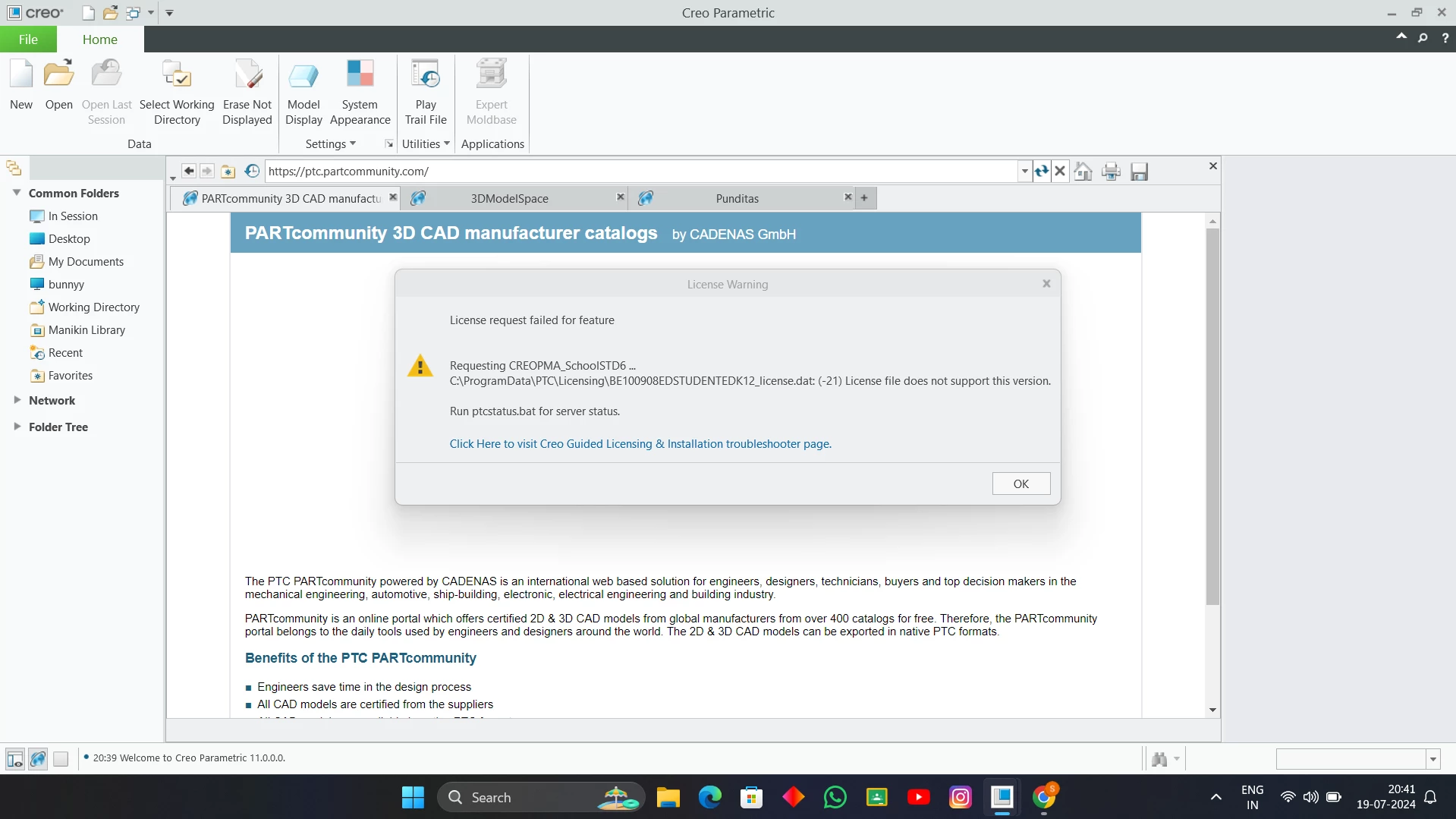

Creo student version liecence request failed erroe code is -21
  • July 20, 2024
  • 2 replies
  • 1040 views
i have installed creo student version but the request has been failed and the error code is -21 how can solve this troubleshoot problem
license file mentioned in error message contains Creo Parametric 10.0 license. It cannot be used to run Creo Parametric 11.0.
Please read following documents:
https://apps.ptc.com/schools/references/install_creo11_schools_standard.pdf
https://apps.ptc.com/schools/references/install_creo11_unistudent_standard.pdf
