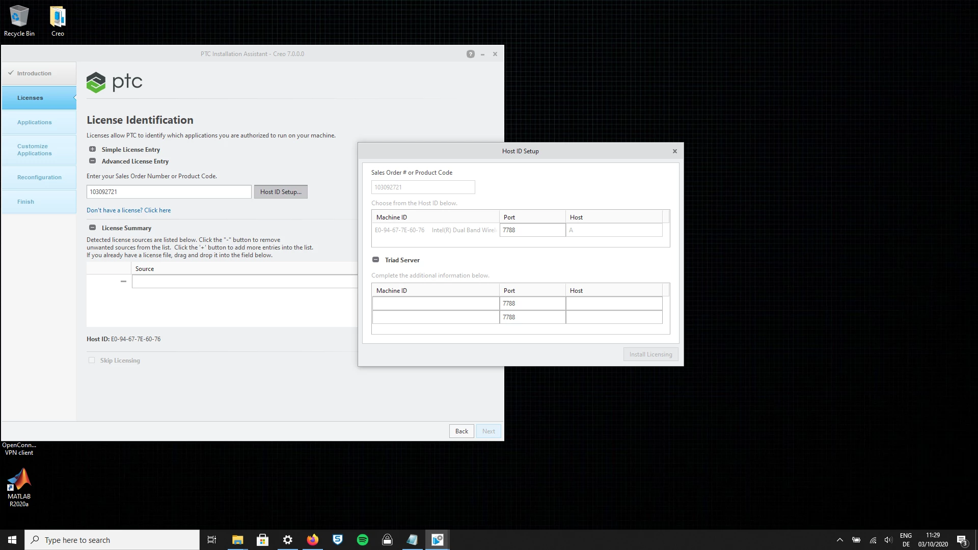

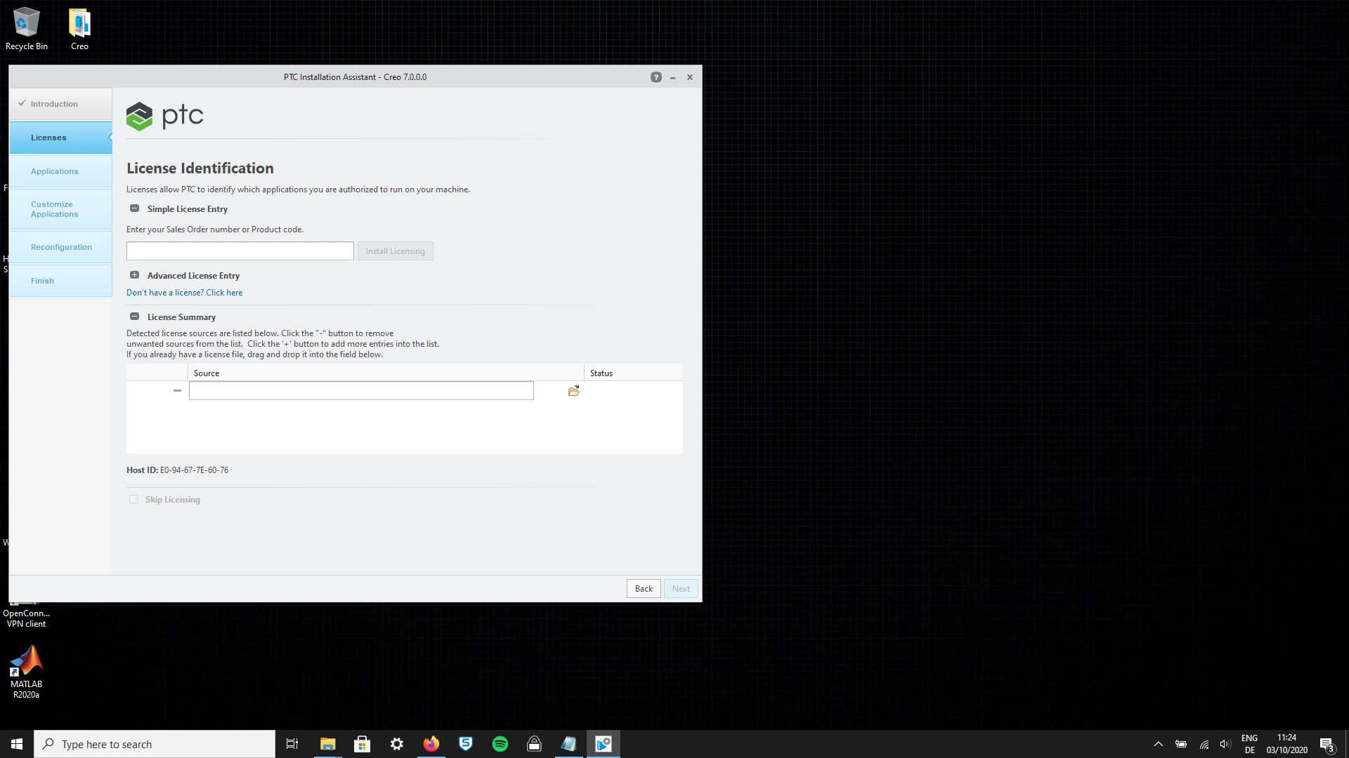

    I have recieved a server address and a port number. The instruction was that after installation i have to write in the licence address and the port number. Now after installing Creo 7.0 i dont see a specific part in the installation window where i can input those two data.
    The following screeshot are the window i see for Licence set up. I did not recieve a Host ID from my University, just the server address and the port number.
    I am little bit confused. Therefore I do not understand what do you need to know.
    In original discussion specification you are writing that you want to create user account.
    In next reply you are writing about Creo installation (and also that somebody gave you server address and a port number).
    Please provide an exact description of what you need.
