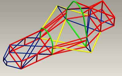

    The AFX extension will work for a tubular type frame like the one below. From my Google results of "monocoque chassis", it appears this frame is not like that so no, it would not work.
    It appears to me that a monocque chassis would be designed using standard Creo tools, just as most designs are created.
