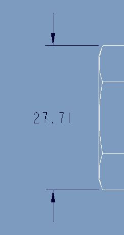

2) when I insert a dimensioning the value is directly between the arrows. But i want to have it above the dimensioning line.
This is, what it looks like at the moment:
And this is how I want to have it look like:

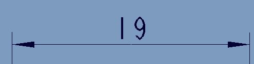

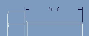

3) again dimensioning: this time I want to have the values turned around:
Make this:
...looking like that:

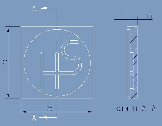

    And again a problem. I guess you can somehow edit a parameter to change the display of this, but i just don't find it.
    This is how it looks like:
    As you see, the arrows marking the section are pointing into the wrong direction...

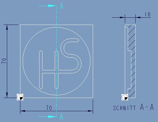

    And here the one how I want it to look like:

    In the Drawing Options change the setting for crossec_arrow_style.

    Thanks for that. I'm kind of ashamed, that I didn't find that one... but now the arrows are in the rigth position, but they are pointing again in the wrong direktion:
    If i change the material removal side it looks like that (the lines in the right section disappeared...):
    I think I tried every option, but didn't find the right one...
