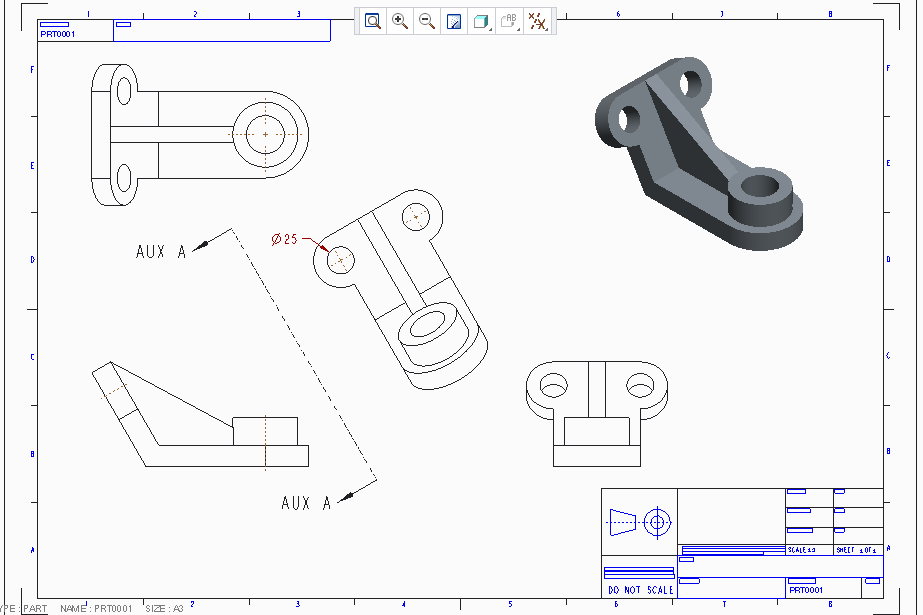

I have students create a part where there is a hole created on a work plane that is 30 degrees off the RIGHT work plane. No problems making them, but when in a DRAWING for the part I can not get a regular dimension for the holes. See attached PDF for example. Other then modifying the dimension for the "ellipse" is there a way to tell Creo that it should display the circle diameter? Any help would be greatly appreciated. Thanks.

    If your hole is not displayed normal to the paper, that is the dimension you will get. You could add an Auxilary view where the surface the hole is placed on, is oriented parallel to the paper.
