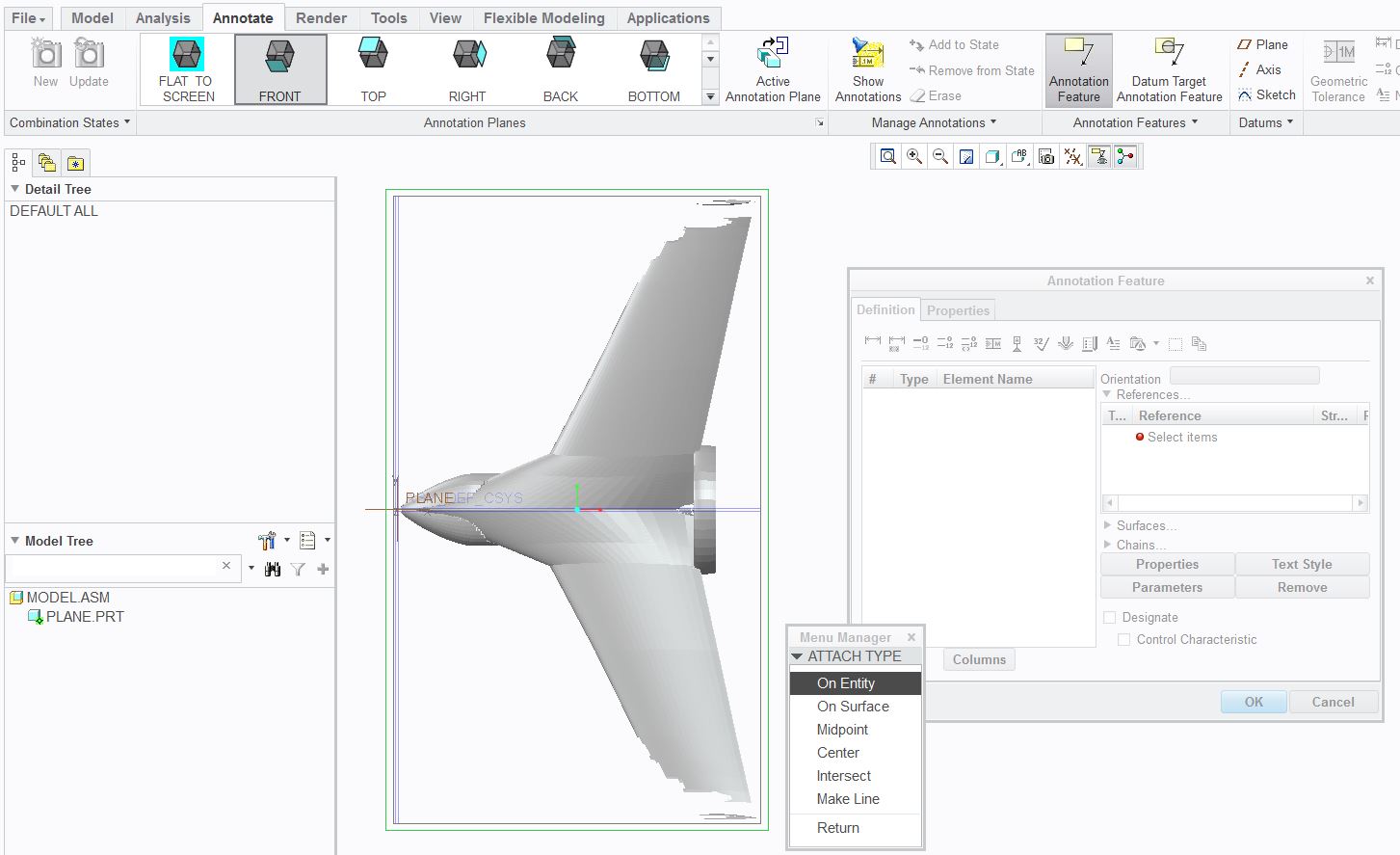

I've imported a VSP file (from the Open VSP program) into Parametric, and now need to add dimensions to the model. The issue is, the model was added without any form of clickable data points (lines, points, etc), and therefore no way of creating dimensions. Any ideas? I hope that made sense...

    For 2D, you can bring the model into a drawing and make any dimensions you'd like. This is also true for a 3D model, but will limit your ability to document the shape to 2D views on a drawing. You can get more information on Drawings in the Creo Help Center by looking at the topic named "Detailed Drawings Overview".
    For 3D, you can create Annotation features on the model to create dimensions, gtols and notes. They are always related to a plane in the model, but can be viewed from any 3D viewpoint. You can get more information on Annotation features in the Creo Help Center by looking at the topic named "About Annotation".

    What format was it imported as? STEP, IGES, other?
    November 2, 2014
    The object (a small aircraft) was modeled in OpenVSP and then imported complete into Creo as an STL file. The problem is that Creo seems to recognize it as a single object, and when the student attempts to add a driven or reference dimension, nothing appears to be selectable. It doesn't seem to matter if On Entity or On Surface is selected, there just doesn't seem to be anything that Creo recognizes as a legitimate feature to attach the dimension to.

    This is a faceted model so it doesn't have entities that Annotate can refer to.
    You should be able to create datum points on the vertices and use those to create dimensions.
    I would probably create datum planes and create a sketched datum curve that is referenced to the vertices. Then, in the sketch, create reference dimensions.
