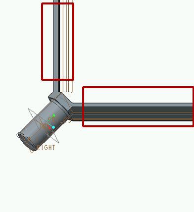

Distortion models PTC Creo 3.0 Parametric academician edition
  • April 5, 2016
  • 2 replies
  • 1268 views
How can I fix it, reinstalled the driver on the video card, this does not work

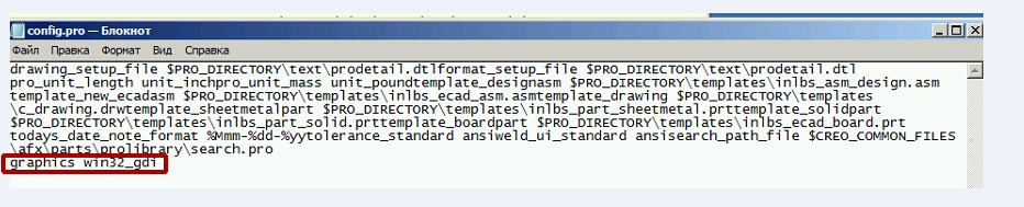

    add the following option into config.pro file (put it at the end of the file):
    graphics win32_gdi
    Then launch Creo.
    MH
    April 6, 2016
    graphics win32_gdi
    Then launch Creo.
    MH
    gamgorky1-VisitorAuthor
    April 6, 2016
    Thank you very much, I have long suffered
    C:\Program Files\PTC\Creo 3.0\M070\Common Files\text
