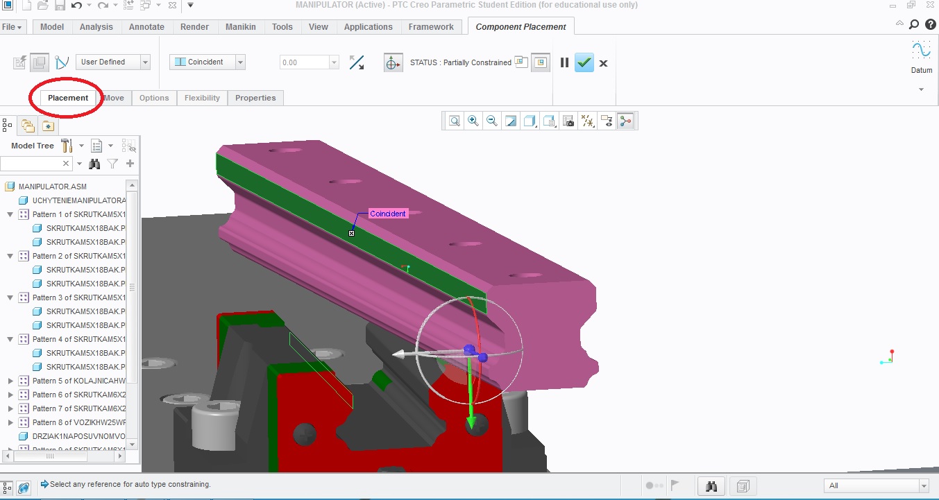

I have problem with placement button in component placemnet . When I do assembly and I want change placement so, placement button don t work. I have creo3 with new student license because I had to recover old. In old version it worked good but in new not. So what I should do ? Thanks for all answer.

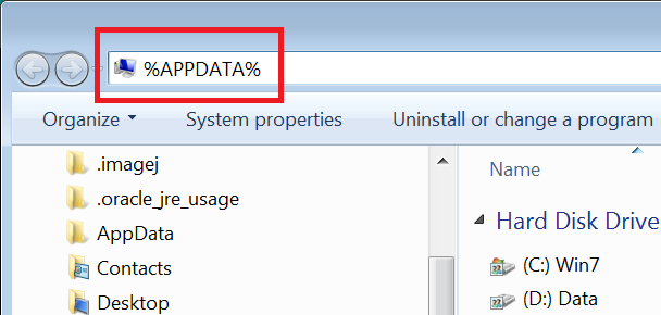

    you can try following:
    • open Windows Explorer and go to %APPDATA% directory
    • delete PTC subdirectory

    Thank you for your answer. I tried to use your advice but it didn t work. It s possible that I did it wrong, because I have in APPDATA two directory 1. LOCAL with PTC  2.ROAMING with PTC . So I don t know which one delete
