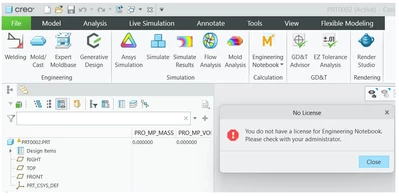

I am using Creo Parametric Release 12.4 and Datecode12.4.0.0
Trying to use Engineering Notebook and it says that our Educational edition has no license. We have been able to use this in previous years. Have done a full uninstall and reinstalled selecting the addon Engineering Notebook.
Here are the errors that I faced
You do not have a license for Engineering Notebook. Please check with your administrator.

it is a Creo 12.4.0.0 bug reported in https://www.ptc.com/en/support/article/CS446362 article. There is no solution at the moment.
Article - CS446362
Engineering Notebook Not Working "No License" Warning in Creo Parametric 12.4.0.0
Modified: 27-Jun-2025   |     Last Seen: 08-Oct-2025
Applies To
  • Creo Parametric 12.4
Description
  • The engineering notebook is not working but its working in previous version on same license file
  • A warning message appears indicating "no license" when attempting to access the Engineering Notebook
  • A dialog with messages You do not have a license for Engineering Notebook. Please check with your administrator. appears when attempting to access the Engineering Notebook
