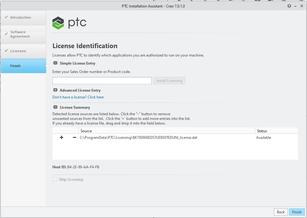

I downloaded Creo 7 Student. When I open the program for the first time it pops up with a "Warning Message List" that says "License request failed for feature." I'll press OK, and then another message that says "AFX failed to load." I'll press OK, and then another message pops up that says "IFX failed to load." I'll press OK after that and it will close out the program.
Best answer by Alex_Cazacu
The license is still on the computer if you clicked the minus in front of the license in the license summary area. Even if you have deleted it from the computer you still have it on your email.
Run setup.exe and drag the license file from C:\ProgramData\PTC\Licensing under the license summary.
In case you no longer see the license in the ProgramData (folder is hidden), save the license you got on your email from PTC and drag that one.
Alex

It seems that the license didn't manage to install. Please try to change the permissions to the PTC folder in Program Files to full permissions for your user, run setup.exe in administrator mode and choose reconfigure existing software.
If the license, containing in its name
BK700908EDSTUDENTEDUNI
is shown under license summary continue, without inserting the code in the simple license area, if the license is not shown or it doesn't have the code in it, please insert the code in the simple license area and continue the licensing.
Alex

Hi Alex,
I have tried to no avail with the License Identification Process. Attached is a photo of what that screen looks like. It appears that the license has already gone through. I ran as administrator and did the whole setup.exe process again. Any suggestions?
Thanks in advance,
Grant
