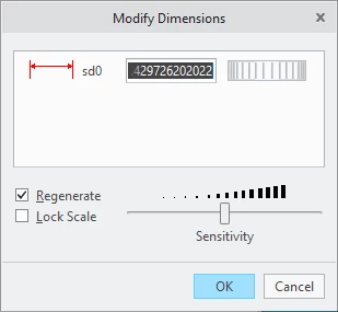

I guess the problem is related to some other software installed on computer.
Try following workaround:
1.] select dimesion and use Modify command from minitoolbar MartinHanak_1-1679298026431.png
2.] edit value in dialog box
