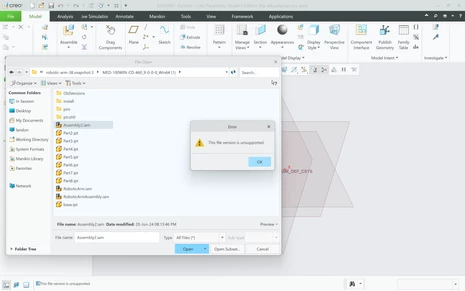

Error importing .iam file from Autodesk Inventor into Creo 9.0
  • June 26, 2024
  • 3 replies
  • 1276 views
Does anyone have a solution to this?
Best answer by MartinHanak
https://www.ptc.com/en/support/article/CS134024 document tells that:
  • Creo 9.0.0.0 can import R11 & 2008 to 2022
  • Creo 9.0.3.0 can import 2023
  • Creo 9.0.7.0 can import 2024
This means import 2025 is not implemented.
June 26, 2024
I don't know if this matters, but it is Autodesk Inventor 2025.
June 27, 2024
