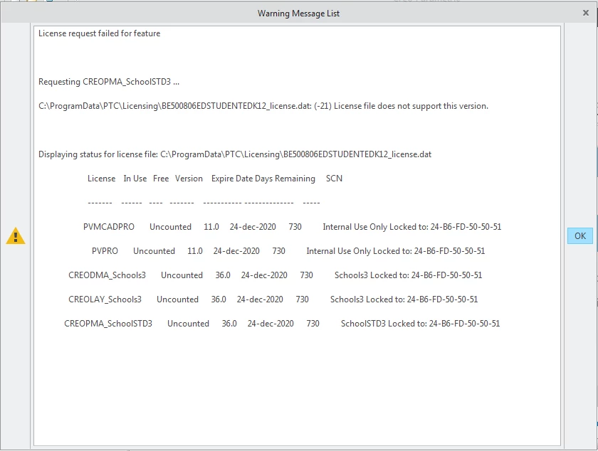

thanks for the messages which I have been trying to work through and see if I can get this to run. On christmas even I uninstalled the v6.0.2.0 that we had on the machine. V5 was never on the machine.
We did get the latest version to install and we received an email headed PTC license pack, but when we click on it to download it seems to do nothing.  I've attached a screen shot of the latest error we get when opening parametrics and the screenshot of the PTC licence pack.
Again, any help you can give to get my daughter in to use this would be appreciated.
thanks
Brian & India

1.]
BE500806EDSTUDENTEDK12_license.dat contains Creo 5.0 license. It does not enable you to start Creo 6.0.
2.]
Uninstall Creo 6.0.
Remove C:\Program Files\PTC directory.
Remove C:\ProgramData\PTC\Licensing directory.
3.]
Install Creo 6.0.
You must enter Product code.
K-12 students can use Product code BE600908EDSTUDENTEDK12
University students can use Product code BK600908EDSTUDENTEDUNI
