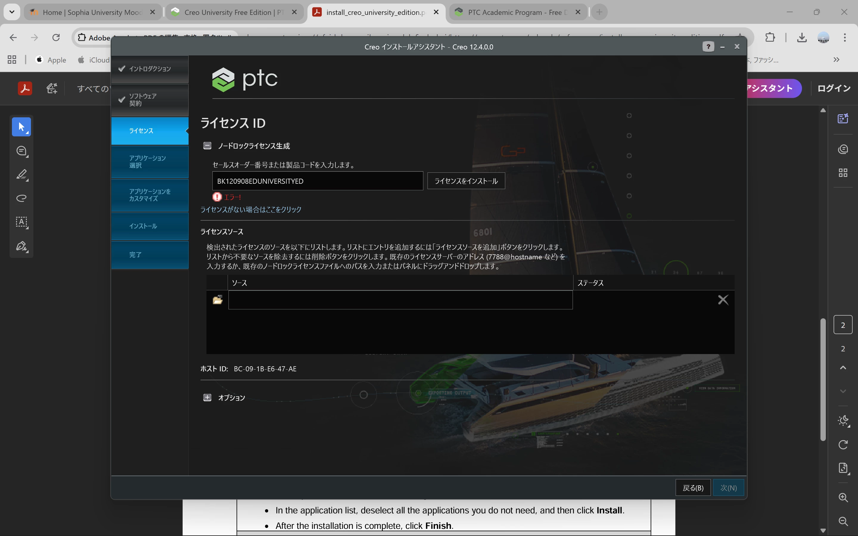

Error when renewing a student license
I’m using Creo Parametric 10.0.9.0 with a student license.
My license expired a few days ago, so I reissued it from the official website.
The PDF said to download Creo 12, so I downloaded Creo 12.
When I opened setup.exe and tried to enter the code, an error occurred and I couldn’t proceed any further.
I’ve deleted the old license from my PC’s folder.
If anyone knows a solution, I’d really appreciate your help.

My problem has been resolved!
I sent an email to "academicsupport@ptc.com," and they sent me the license (.dat) file directly. It took about one business day to receive a reply.
If you are stuck at the license entry screen, I recommend reaching out to them. I hope this helps others facing the same issue! ;)

In my case, I followed these steps:
​First, I sent an email from my university email address. The next day, I tried requesting support via Teams through the AI chatbot at the bottom right of the official website.
​Shortly after, PTC Support canceled the meeting request, explaining that the free version is not eligible for live support. (I received an email notification about this at my university address.)
​Since I still hadn’t heard back from my initial inquiry, I sent another email with the same message from my personal email account. A few hours later, the license file finally arrived in my university email inbox (not the personal one).
​That’s everything I did. It seems that being persistent and trying different contact methods might help speed up the process.
​I hope this helps resolve your issue!
