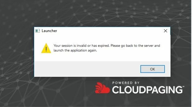

Error “Your session is invalid or has expired” when Launching Creo Trial Player
Issues:
User encounters error "Error “Your session is invalid or has expired” when Launching Creo Trial Player
Reasons/Causes: -
  • This issue is encountered when Multiple sessions have been launched for Creo Parametric Trial

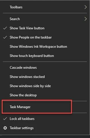

  • Open Task Manager
    • Right-click the Windows taskbar and select “Task Manager”
  • Or Search in windows i.e. type in “Task Manager” and  open it.
    • Select Processes tab and confirm multiple session have been launched
    • Right click on Creo 8.0.0.0 from PTC and select End Task
  • Relaunch Creo Parametric 8 trial version
