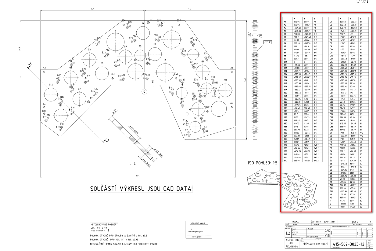

Tthlavinka1-Visitor12 years agoOctober 14, 2014Questionexporting a table with coordinates from model0 replies703 viewsTranslate AllHello, is there some possibility to export x and y coordinates of each hole from model (as shown od the drawing below), put them into a drawing and export to excel file?There is a zero point on one hole...Thanx for help1_zakjladna-prt-15.zip
