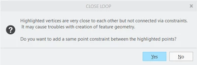

😎 Around 100 times click "No" on these windows (and then I got file "Bookend.prt"):

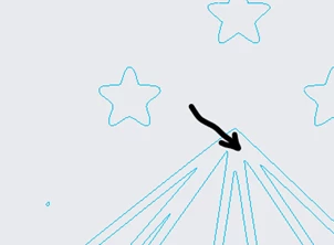

Step 9 is the one which I am unable to do. I can select the space between lines (see image below):
and when I click here, then message "No geometry was created" appears in message log:

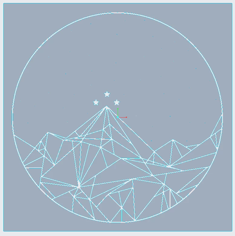

What I tried to do is make a "negative" of this model, so I would substract this negative from a cylinder and then get the final relief I want. But I figured out it is also impossible to extrude the last two planes (see file Best_Attempt.prt) - the same message "No geometry was created" appears. There is a distance, but no geometry:

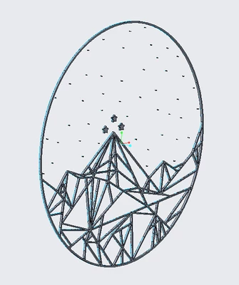

Feb 19, 2021 3:35 PM UTC
Dear @MartinHanak ,
that's the exact solution I was looking for. Thank you so much! Here is the result I was looking for many hours (I rotated the model a little bit, so you can see 3D shape) and which I already got after first projection when I was following your instructions.
