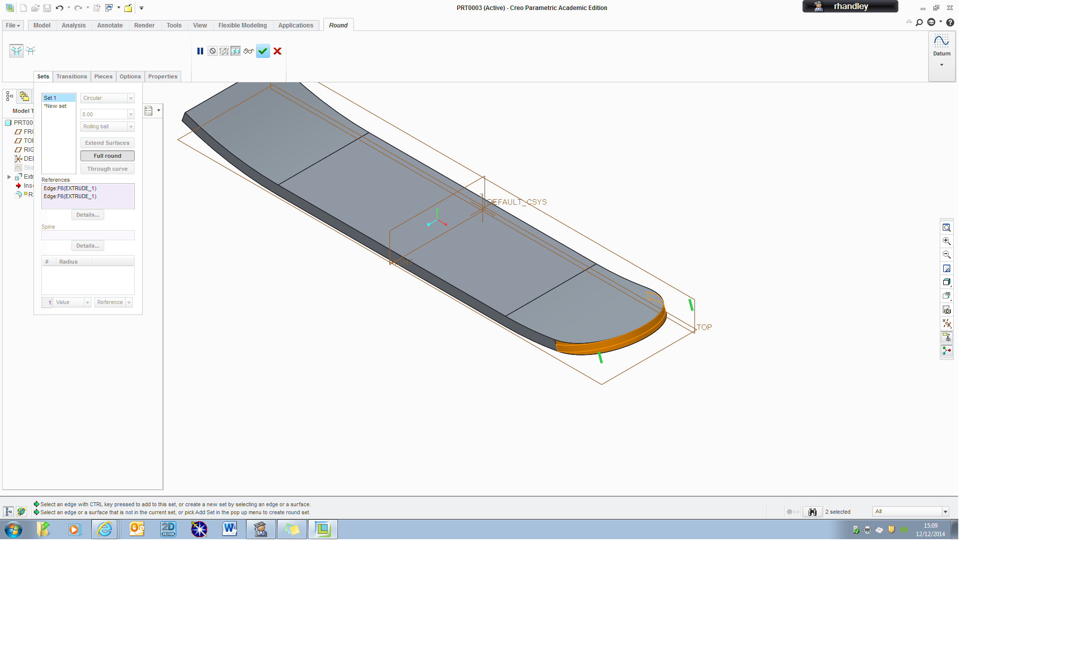

    Hi George
    Do you mean something like the screen-shot below? This was simply done with the round tool - select the two corners (highlighted green) by holding down the control key and then choose 'full round' from the 'Sets' tab within the round dialogue box.
    If this isn't what you want, attach a screen shot so that we can see where you are so far?
    December 12, 2014
    I never thought of that, it would actually work for this yes.

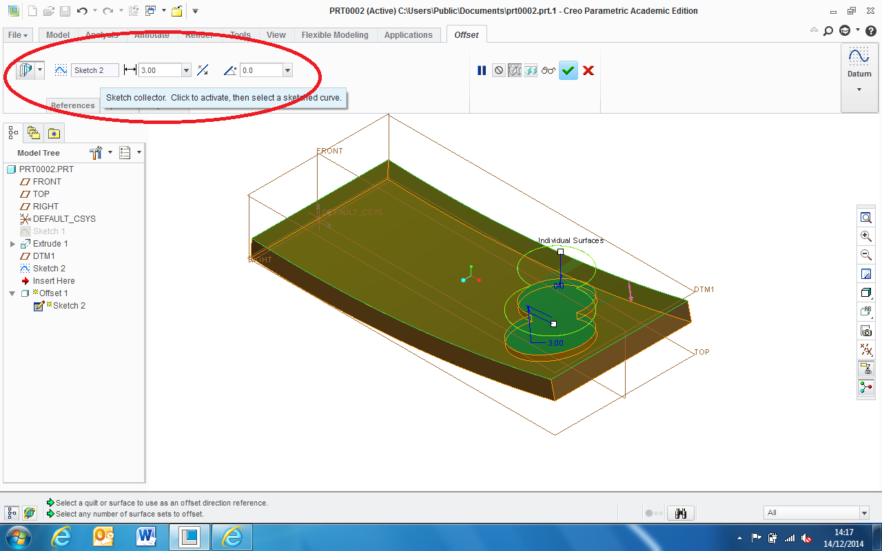

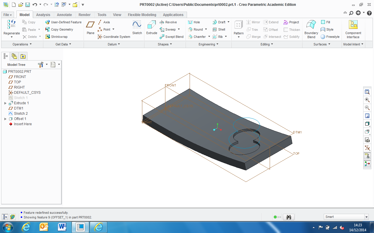

    But I am still curious how you do extruded off a curved surface, say for example I wanted engrave a design into the nose or tail. Obviously I could create a plane above it but as its curved, the engraving would have different depths.
    December 14, 2014
    Hi George
    • Add a new plane above the curved surface and draw a sketch on it.
    • Click on Offset on the Editing Tab
    • Select the curved surface (hold down the Alt key to do this)
    • Select the 'With Draft' option top left corner of screen
    • Click in the sketch collector box and select your sketch
    • Add the depth you require
    • Add a draft angle if required
    I hope this is what you want.
