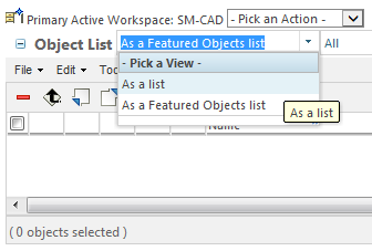

We have checked in a part to our windchill server, but when we click the "open" button in creo, the part is still displayed in the workspace. It seems to be that the local workspace in creo and the workspace I can see using windchill are not in sync. I have attached some screen shots to hopefully explain this better.
This is where we checked-in our part. It is clearly not in the workspace, according to windchill.
Then we click the "open" button in the upper-left corner, and the part still pops up.
Our main concern is with big complex assemblies, certain components may not check-in later, which was more or less our problem last year. We made a few mistakes when handling windchill last year and we want to make sure that this is not one of them.

    Trevor, in your screen shots, you have changed the object list filter from "As a list" to "As a Featured Objects list". If you change it back to "As a list", you should be all set.

    Once I changed it to "As a list" it displayed the part everywhere. This would therefore mean that even though we check-in an object, the part still remains in the workspace. Is there a setting we can change so that we have to check out the part to see it in the workspace, because the current setup may lead to some confusion.
