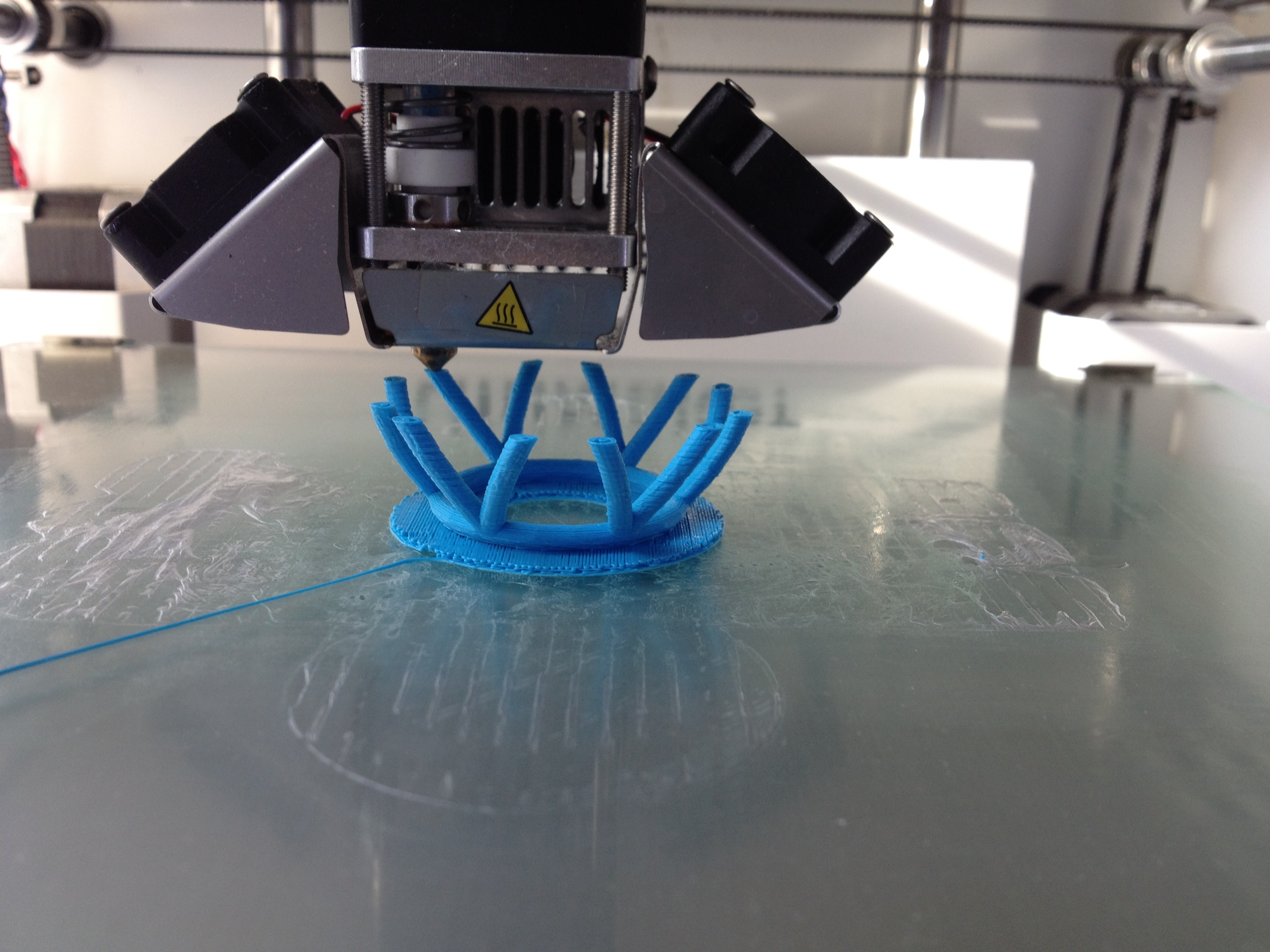

    March 11, 2015
    I've had an Ultimaker 2 3D printer on loan for a couple of weeks and decided to try this model.  The build time was just over two hours and it was fascinating to see the spiral arms growing without any support!
    Video Link : 5853
    I am very impressed with the Ultimaker 2, 3D printer and Cura slicing software. Both are very easy to set up and get printing. In two weeks of almost continuous printing the only problem has been a blocked nozzle. This was easily sorted using the clear online guides and a quick call to their tech support. A high quality product and excellent support.
