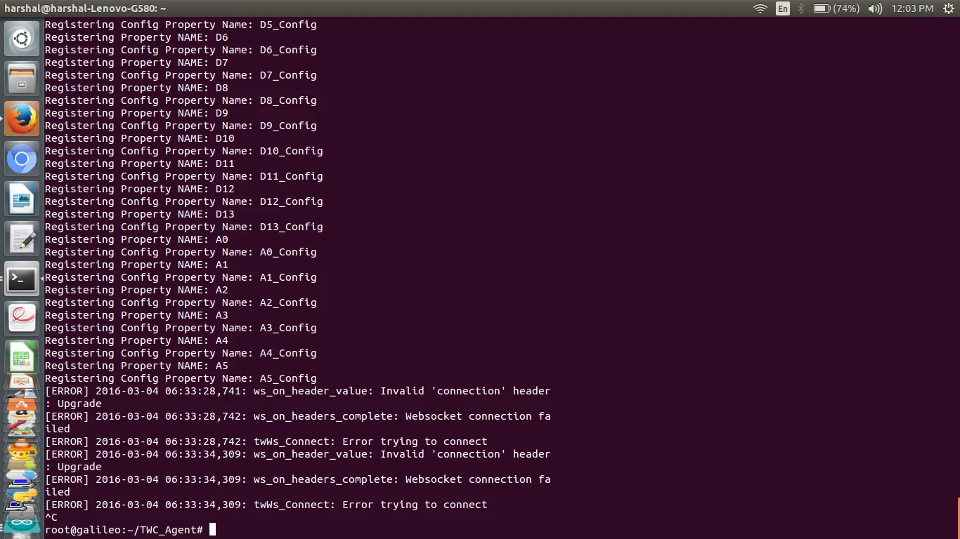

I am working on galileo gen board 2, and doing a project of weather project. The properties are not getting connected to PTC. I am having a issue on the TWC_Agent, while manually running TWC_Agent, it is showing some errors as "Error trying to connect" & "invalid 'connection' header" and "websocket connection failed". If someone has came across these errors kindly share solution

Harshal, do you have any proxy server in place?

No, there is no proxy server. But I do have a Wi-Fi router, Will that have any effect?

I've seen the invalid upgrade error few times, and it has been with connections involving reverse proxy (as it sends back 2 extra headers). Using the latest version of the Edge MicroServer should fix that.

Actually my network had the problem, I tried on my friends network, it is working now.
