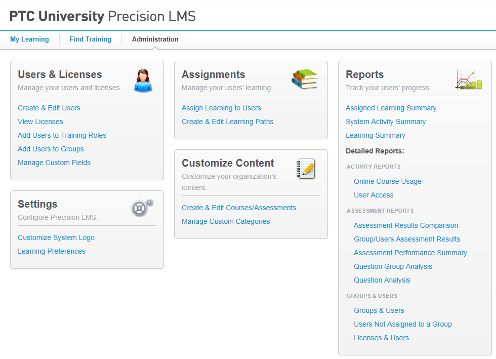

    Please contact PTC with this question. They have curriculums with all the tools you need as an instructor. It is something you might need to budget for but their programs are very comprehensive. Here is a screenshot of what is offered to teachers:
    Short of this you have some homework to do. If nothing else, see if you can get an evaluation license. You might find out exactly what level you want to bring your students to and in what timeframe.

    The PTC Academic Program provides teachers and students in middle and high schools with access to Precision LMS e-learning. Over 2000 hours of multi-media tutorials cover most of the features in PTC Creo. We can assign your students PLMS Accounts to you as their teacher giving you access to assign courses and view their performance in the end of course multiple choice tests. Complete a support request form and we will send details how to get your students linked to your PLMS account.
    www.ptc.com/go/academic-support
