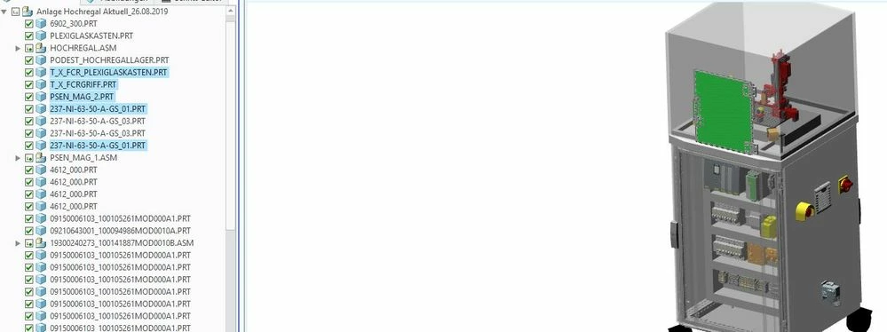

i have another question. Is there a possibility to group single objects to one module?
For example i want to move a door in my 3D-model. The .STP Import created many single objects.
Now i have to mark five single objects to move the door. I want to group the five marked objects and
name them "Door".
I want to group the blue marked objects in the picture. This would make everything much easier.
Thanks for your help.
Best regards
Marco

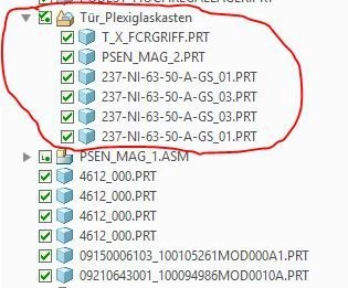

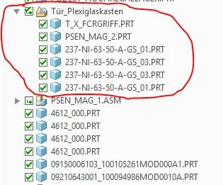

i'm bit late. Today i tried to group my marked Objects and it worked!
Thank you very much for your help.
Here is my grouped object named "Door_Acrylic glass box"
