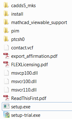

Having followed the process to sign up for a student copy of Creo 2, I have installed the software as directed, however when I start the software it notes on the startup page that this is a 30-day trial copy.
The web site states that students get a one year license copy? What have I done wrong?

Hi James,
You are correct in that students receive a free copy of Creo 2.0. It appears to me that you clicked on setup-trial instead of setup when you were installing. To fix this, just run the regular setup file from the install files that you downloaded and you should be all set.
Please let me know if you have any questions!
