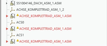

We want to export a pvz as obj (or any other 3D-format that Unreal Engine supports).
If we import the .pvz as geometry model into Creo Parametric, we get a few error reports without context. The export for all other components work fine but the ones with errors don´t get exported with them.
If we import it as automatic (or facet) to Creo Parametric, we have no errors but 0 triangles on export.
Are there any reasons why some components are faulty imported as geometry model?
We did not create said pvz file, could this be a problem on the creators side, either while creating or exporting?
we have tried pretty much everything we found online, please help!!
